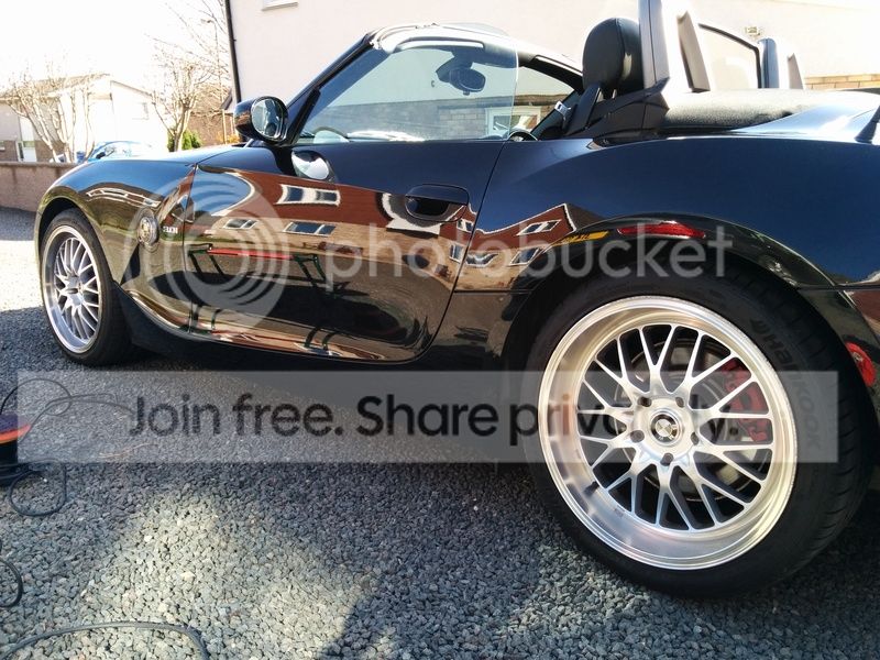

Fair enough but the end result is still bloody awesome I think mate. :thumbsup:Stunning shine on a great car, like the wheels too, very much, look great on a darker coloured car.:)
