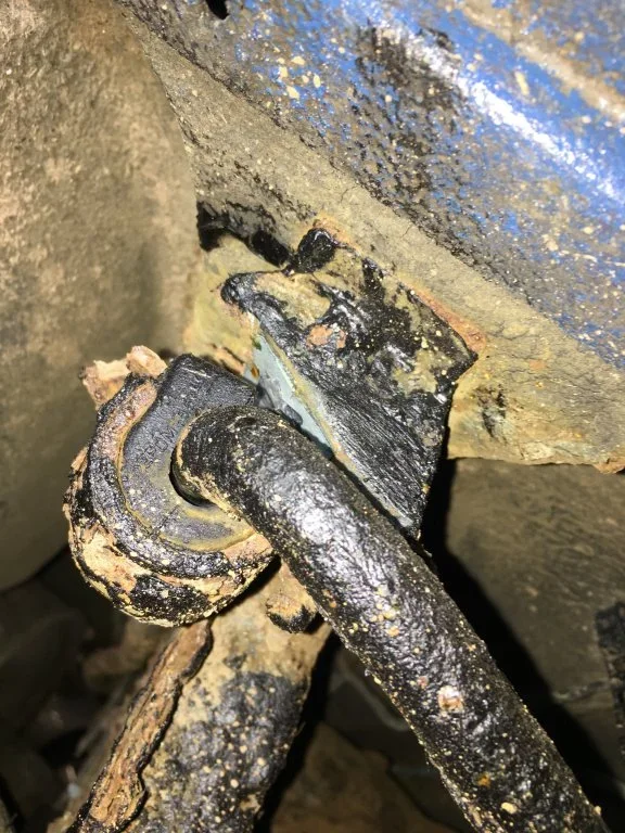

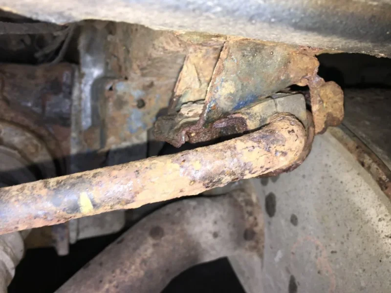

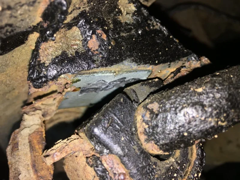

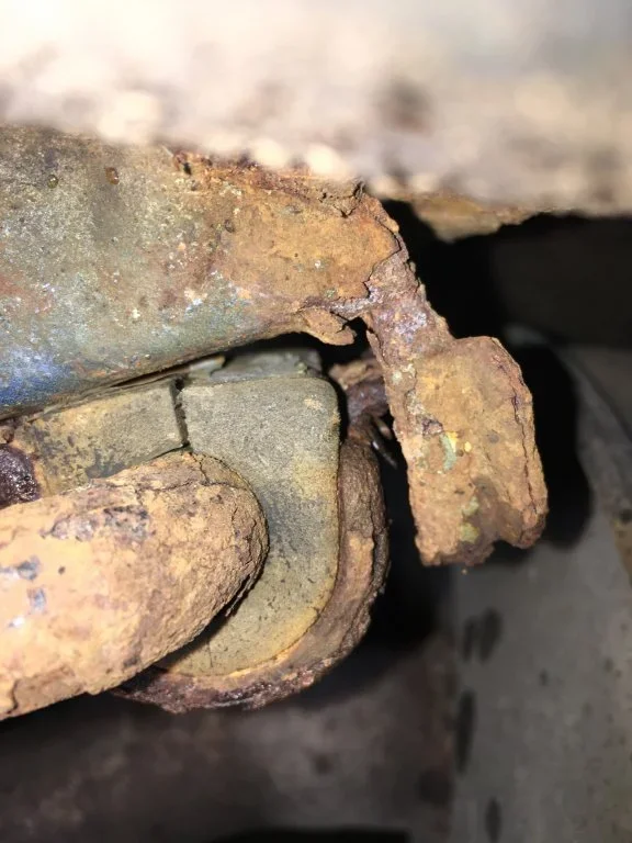

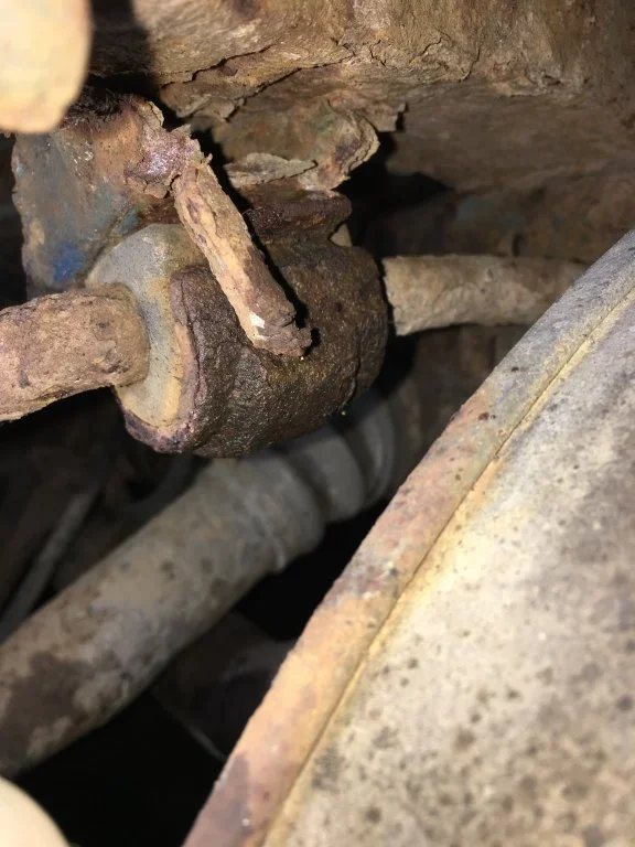

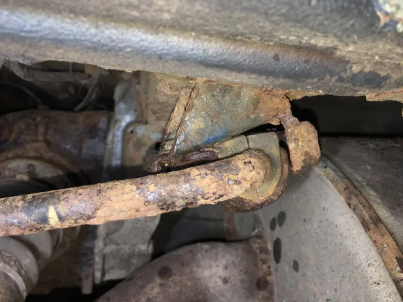

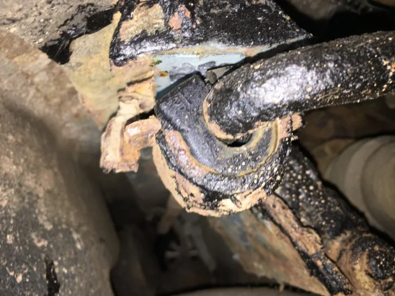

I have been trying to diagnose the renowned clunking sound when releasing the clutch in 1st/2nd/reverse and whlst doing this, noticed my rear ARB bushes brackets/supports were totally rusted and seem unfunctional. As you can see in the photos, one side even looks like its had a cheap fix in the past where they've welded a small plate on the chassis to reinforce everything.
Going to need a repair...however does anyone have any photos of what a normal, un-rusted chassis in this area looks like please? The photo of interest would ideally be without the sway bar and without the bush bracket on to see what the 'chassis-end' looks like.
Does anyone have any experience of repairing these?

They are shot looks like they are rotted through i can not find any other pic showing it than the ine above but if no one can help i can always get under the car and take some.

Hi @Mazza - that's great - thank you so much. I saw your first photo on one of your posts, but then wanted to see the 'underside' of the bush support without it attached to the car.
Any ideas on a possible fix? I presume I would need to get the attachment fabricated and welded onto the car after all the rusted rot has been removed.

I would imagine so the brackets are possibly availible from Bmw but if not a resident breaker may help you there they may be able to get the mounts cut out for you to get cleaned up and welded back in :thumbsup:

Heres a couple of mine, you can see they have side tabs that will be spot welded, I am currently breaking a 1.9 but dont know how good they are

Not on a Z, I've repaired brackets like that using box section, it's easy to cut to shape and the flat section with a couple of holes drilled in can be self tapped in position, then nudged until aligned and welded.

The rear ARB brackets are only held on by 4 small spot welds, very poor design again by BMW, I had one pull off on the M in Scotland, not because of rust, but probably exuberance :whistle: got it seam welded back on by a local garage for peanuts, must remember to get the other side seam welded too. ;)

Updating an older post - managed to get OEM brackets from this site https://www.schmiedmann.com/ - based in Denmark and about £20 delivery to UK, but literally has I think every part you could want.
Turns out it wasn't the cause of the clunk, but I think I found the culprit in a very loose rear axle bushing - about 2cm of play!
