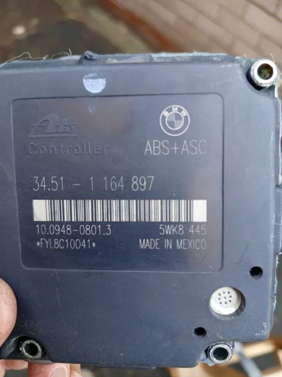

Ok so a few years ago I chased down an ABS problem, eventually soldering the two joints in the AAB S box. I was very pleased with myself 😁. Well today the light is back on. Bugger. I'm guessing is the solder joints again. Will start exploring it Friday.
Correct me if wrong but a code reader doesn't properly detect the ABS box issues..
Well fixed it, then it's gone faulty again. I think it's time for a professional fix. I've read that BBReman was the place to go for a refurb. Are they still about? If not. Any recommendations thanks
@Trevor /chedder I don’t know which unit you need but I have two spare modules (just the ECU not the pump). You are welcome to one of them (free) if you want? I can check the part number when I get home later?
Fab thanks, really appreciated. Here is a piccy of my pump
