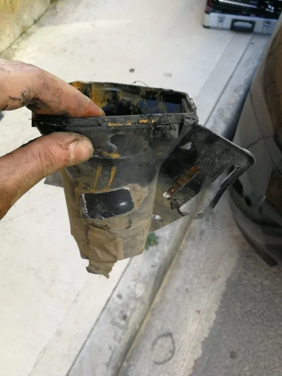

the plastic container the motor is in is fixed to the hood hinge with a cable tie & a small tang if you stand by the passenger door & remove the rubber cover & with a long knife cut the cable tie & the plastic side piece the whole lot comes out in one piece.

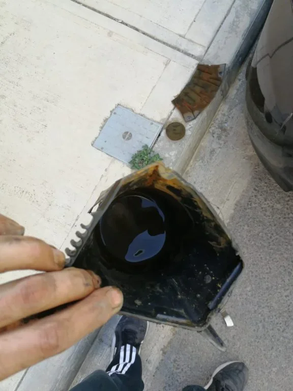

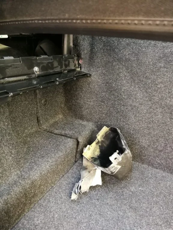

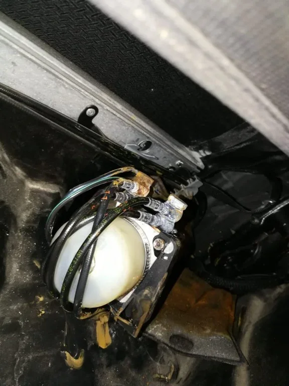

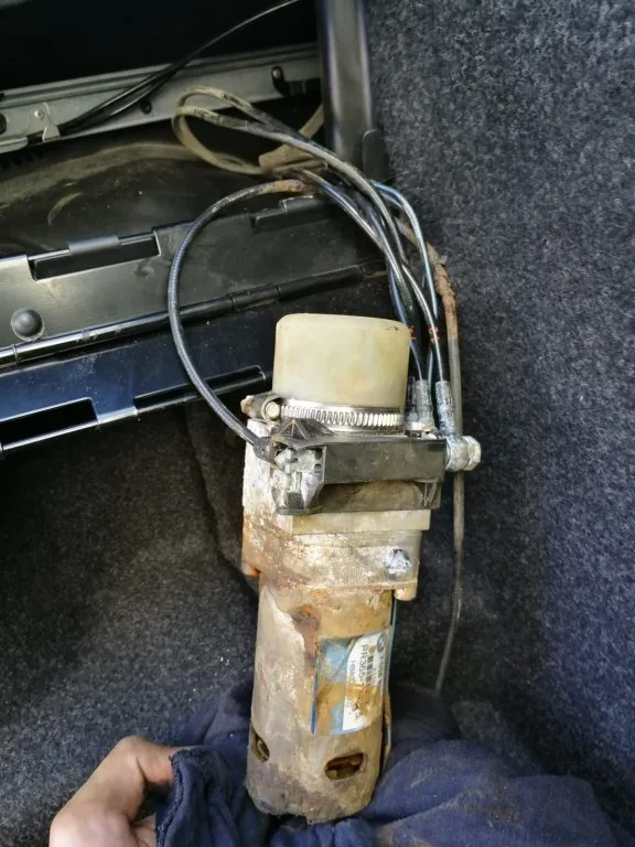

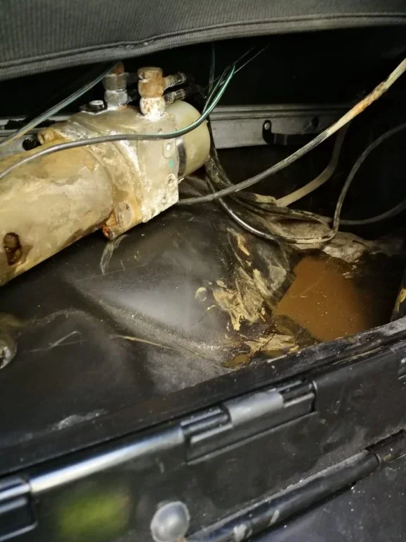

Many many thanks @gookah. Following his guide I moved the roof motor in my trunk. It was not difficult, patience and some good pull when need it. I found a lot of water and the roof motor was dead. I sprayed it with different electrical an WD40 products and now it is working again but the roof does not move. When I press the button to open or close the roof, the other roof engine inside the car start and open and close only the metallic hinges on the windscreen, later on also the trunk motor start but the roof does not move. Any suggestion? Air in the idraulic circuit, roof motor lost power, idraulic piston locked?
I will attach some photos from the job done.
Many thanks in advance.

Make sure the pump is the correct way up, and upright, with the reservoir on the top. so that the oil gets in to it.
you may have pumped some air into it, but it should clear once you get the oil flowing back into the pump.

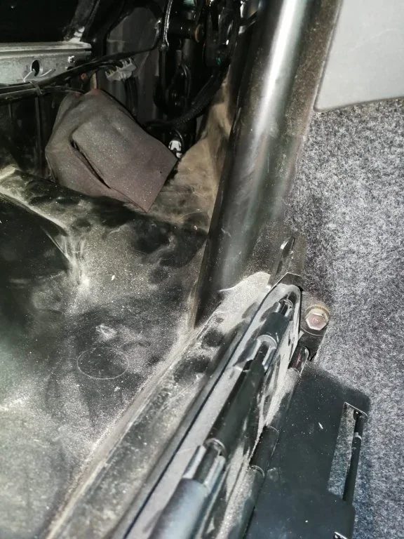

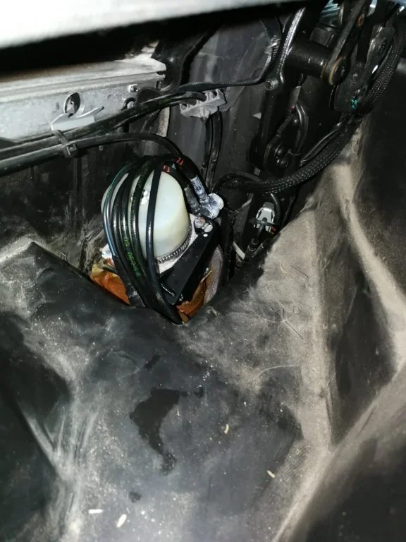

Just did my relocate. At first it appeared the lines were too short to get the motor fully into the trunk. What I discovered was that the cable for The roof release for operating the motor manually was wrapped around the motor down in the original installation space causing the motor to not come out. This was discovered using a scope camera. Once the cable was unwrapped there was lots of line to get the motor into the trunk, after drilling an access space in the panel

Brill write up, I am following this guide and so far everything is working well. My motor is sitting in diesel overnight and will hopefully come back to life tomorrow.
I did find getting the "cap" off the motor housing was the key to getting the motor out. I used my trusty Gerber knife attachment to cut through the cloth tape, unpicked the tape and then pulled like crazy on the cap and out it came, the rest is easy getting the motor out.

is the oil reservoir at the top or underneath?
It must be on top of the motor
